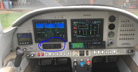

- Posts: 10
- Joined: Sat Jun 22, 2024 12:13 am
Yes the control head is mounted flat on the instrument panel. See attached photo.
- panel.PNG (243.67 KiB) Viewed 12833 times
- Posts: 227
- Joined: Tue Nov 22, 2022 3:56 pm
- Location: KMRH
Ok that’s good. Did you complete the ground setup and test.
Also does the system do these weird movements when you use the heading bug. Also how about when it does NAV only to a VOR? I am in knowing if it’s just acting weird with GPS steering commands.
