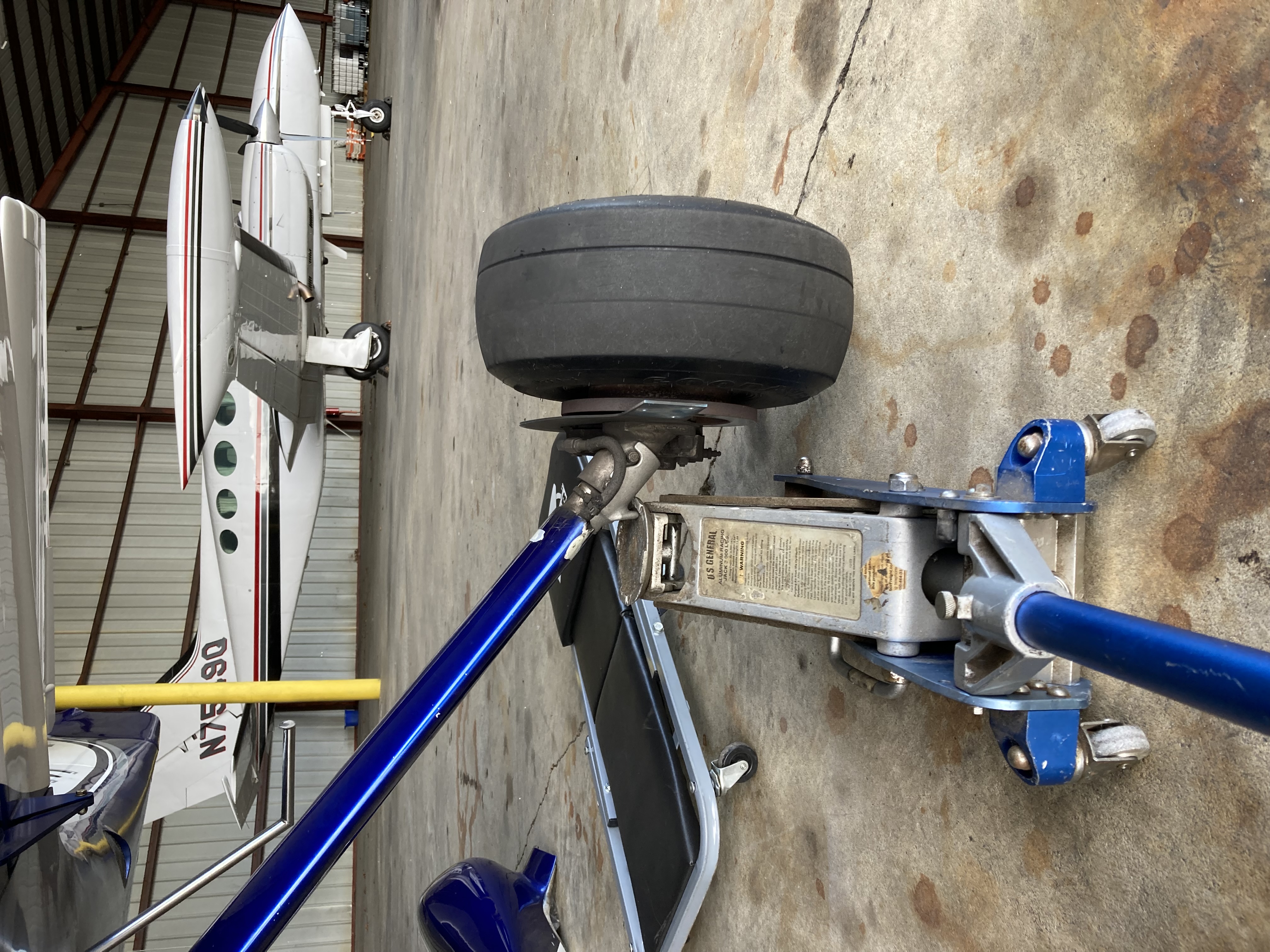

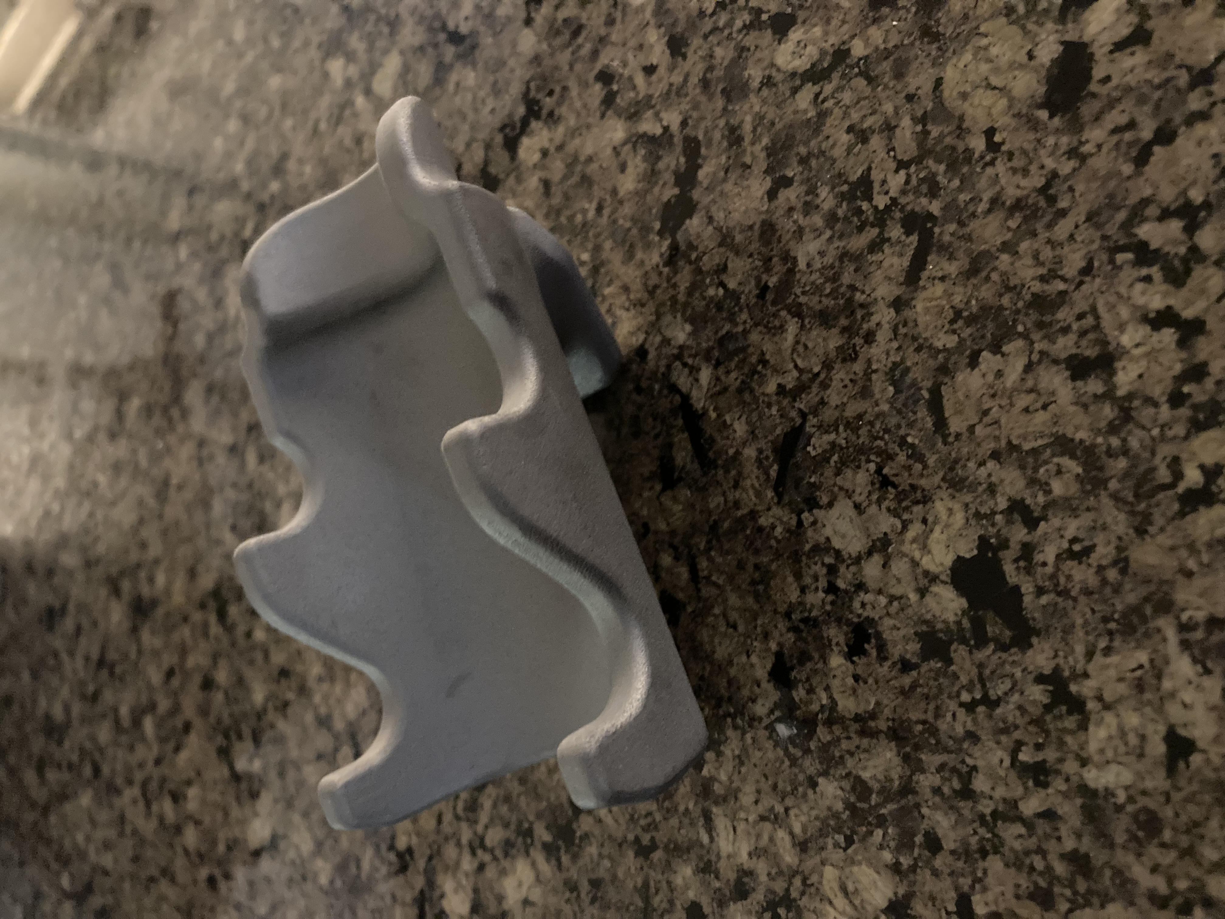

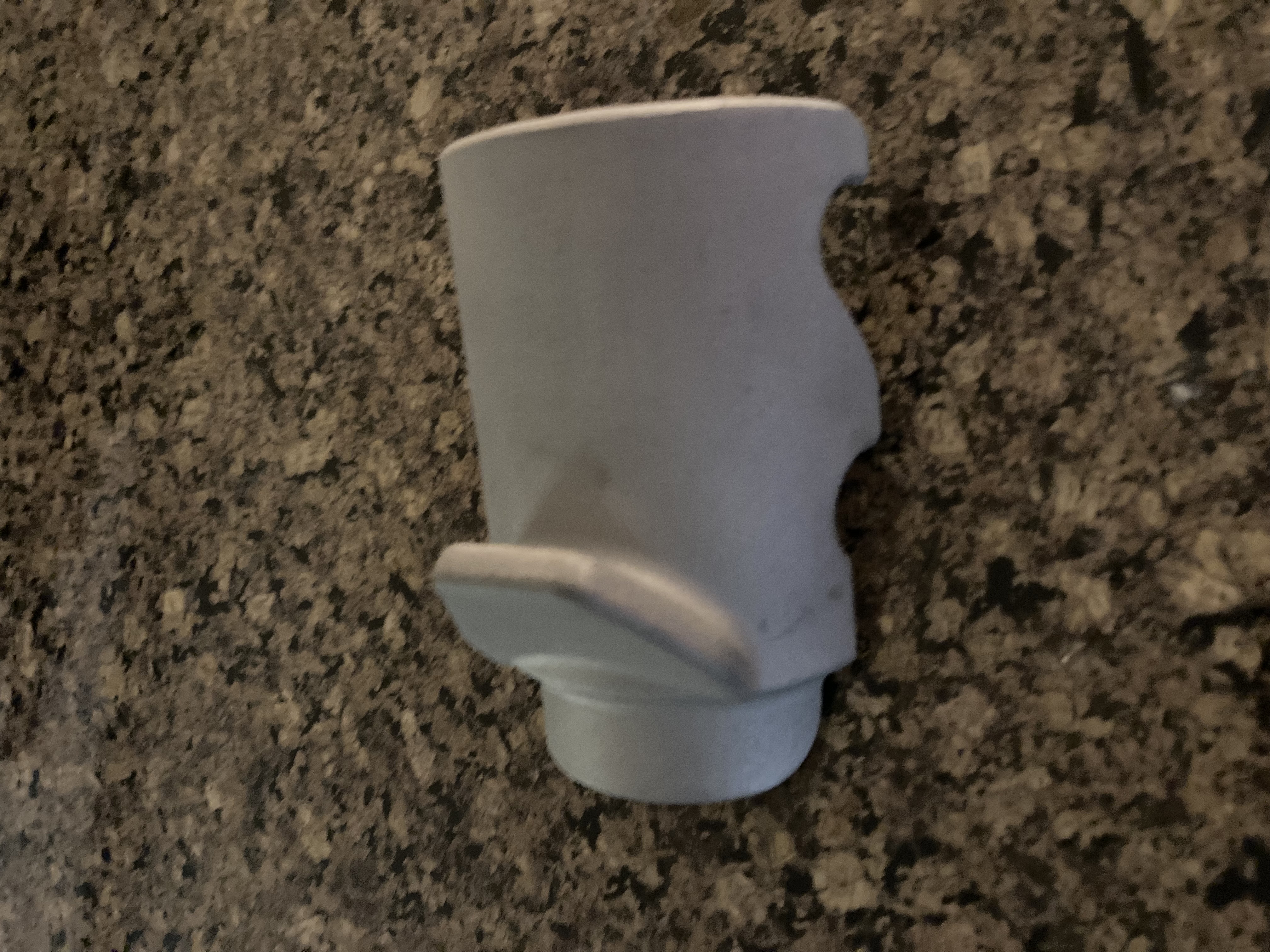

Drew:
You can get the ES adapter thru Unionfab.com by creating an account and submitting a quote to purchase from a previous order: Order ID: XJ20240306-9678358659-2. With shipping it was around $200. You likely only need one, as you probably aren’t going to have a need to jack both sides at the same time. The wheel fairing needs to be removed to utilize. A few pictures of what it looks like and how to use it below.

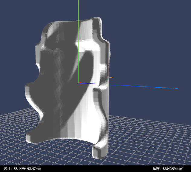

Thanks all for the assist here.
Matt's source (unionfab.com) was able to resurrect the previous order and is going to produce.
Landed cost is roughly $200 bucks for a single. Their rendering attached.
I am ordering a single today, if anyone else needs one of these, let me know and happy to tag it on to my order.
