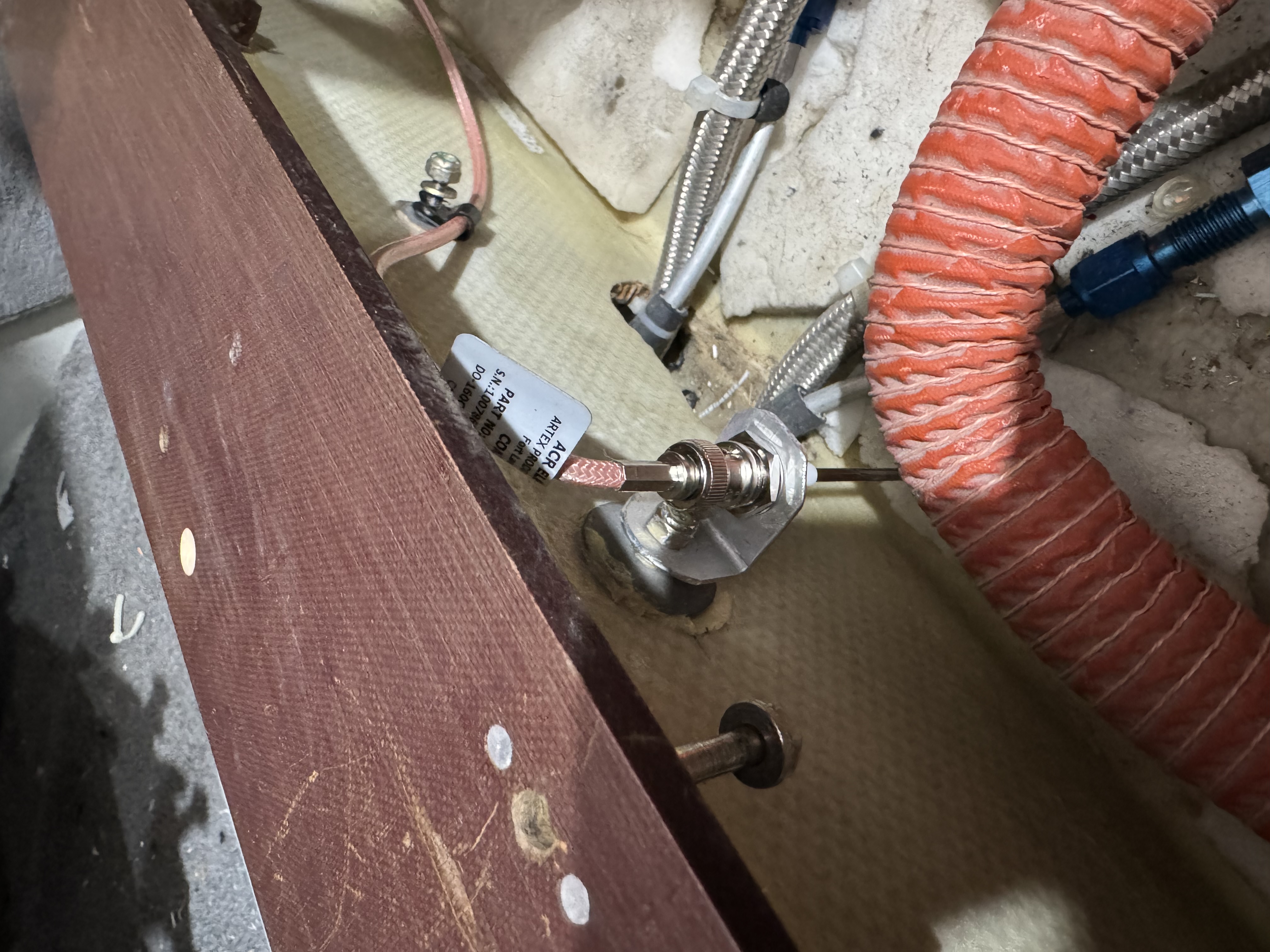

I did some tests with the ADSB antenna and found that it works pretty much anywhere inside the cockpit mounted vertically and horizontally. I decided to mount it vertically under the pilot seat. It’s more than 3’ away from any antenna. Works great. Traffic displays on both AFS-6600 panels. I really like that is shows on both the PFD (with altitude delta) and MFD (god’s eye view).
For those who go from a GTX-345 to Dynon, Garmin uses one blade antenna for both their Transponder and ADSB, whereas Dynon uses two different antennas. Displayed below is the ADSB antenna inside and the original transponder antenna outside.

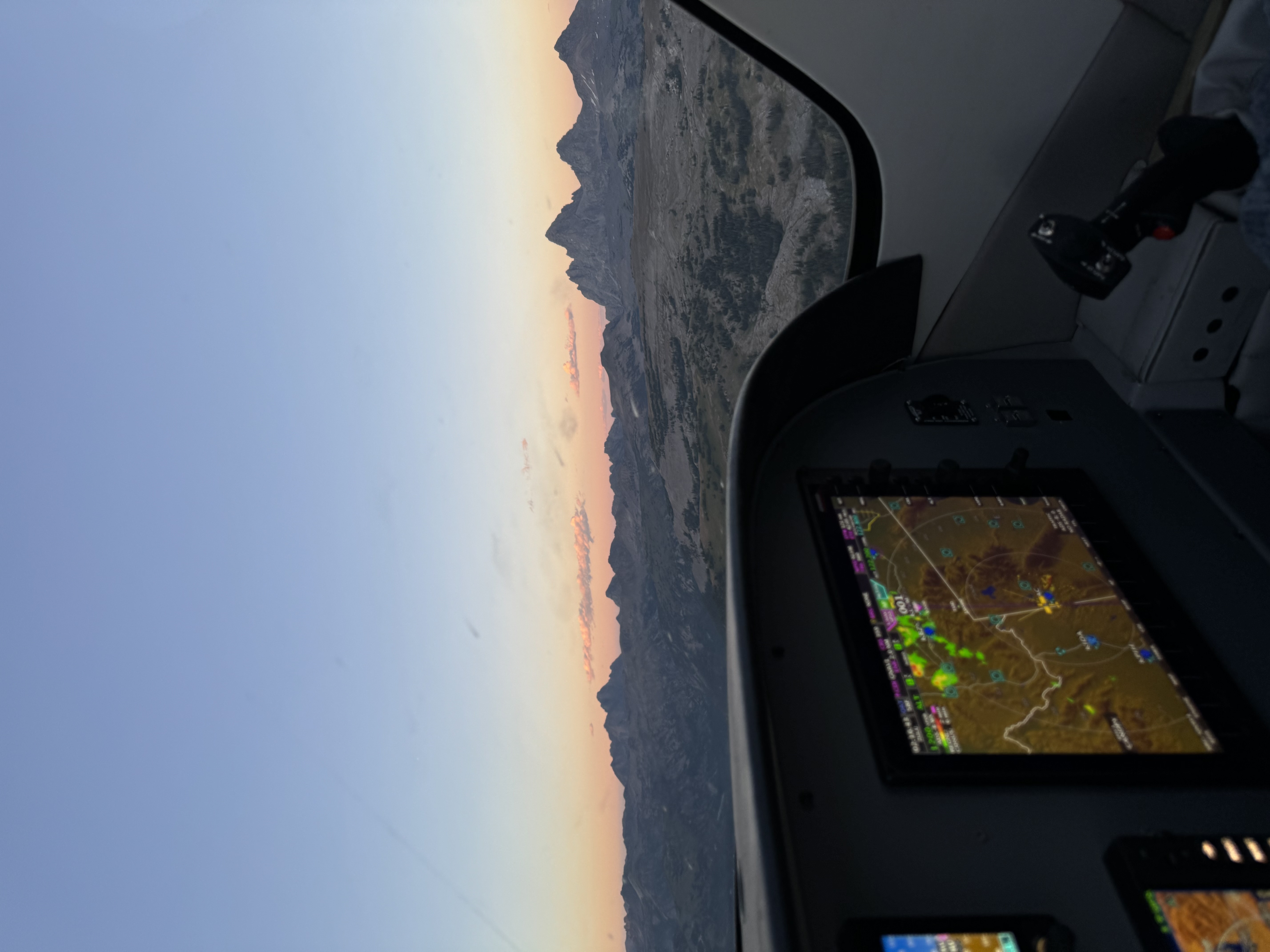

I have more lessons, but will wait for another post. Picture included because flying a new panel past the Grand Tetons is cool!
