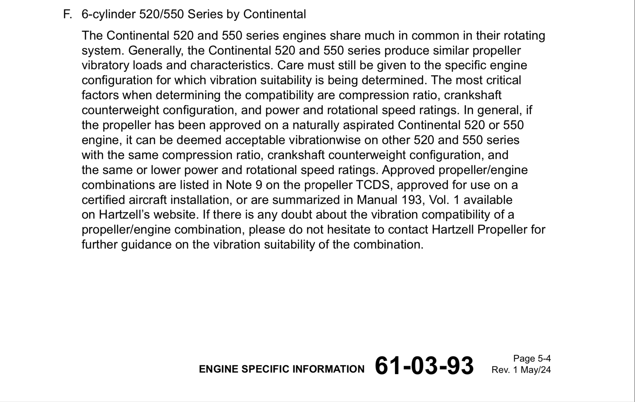

Hartzell has several statements regarding engine/prop combinations:
1. “The most critical factors when determining the compatibility are compression ratio, crankshaft counterweight configuration, and power and rotational speed ratings.”
2. “In general, if the propeller has been approved on a naturally aspirated Continental 520 or 550 engine, it can be deemed acceptable vibrationwise on other 520 and 550 series with the same compression ratio, crankshaft counterweight configuration, and the same or lower power and rotational speed ratings.”
3. “Approved propeller/engine combinations are listed in Note 9 on the propeller TCDS, approved for use on a certified aircraft installation, or are summarized in Manual 193, Vol. 1”
Performance Engines was well-known for delivering engines with higher compression ratios, higher horsepower (through multiple methods), and using higher RPM than factory engines. They also commonly did other modifications including different pistons and changes to crankshaft balance. Any of these could have put the engine prop combination outside of the design envelope that Continental and/or the prop manufacturer tested.
Interestingly, Hartzell states on their website the approved prop for the IV and IV-P as the PHC-H3YF-1RF/F7693DF. The engines shown are: “TSIO-550-B,-E 350 hp @ 2700 rpm, 10-550-G 280 hp @ 2500 rpm.” However, looking at the stated limits for that prop shows a maximum compression ratio of “8.5:1 or less” and a maximum engine rating of “310 HP at 2700 RPM.” Why would they approve a prop/engine combo that is outside of their own quoted design limits for the propeller if they thought it might be a problem? The answer to your overall question doesn’t seem quite as clear cut given all of this information.
I’ve attached photos from the manuals and website if you’re curious to review them further.
- IMG_2007.jpeg (795.99 KiB) Viewed 38679 times
- IMG_2009.jpeg (575.02 KiB) Viewed 38679 times
- IMG_2008.jpeg (621.45 KiB) Viewed 38679 times
