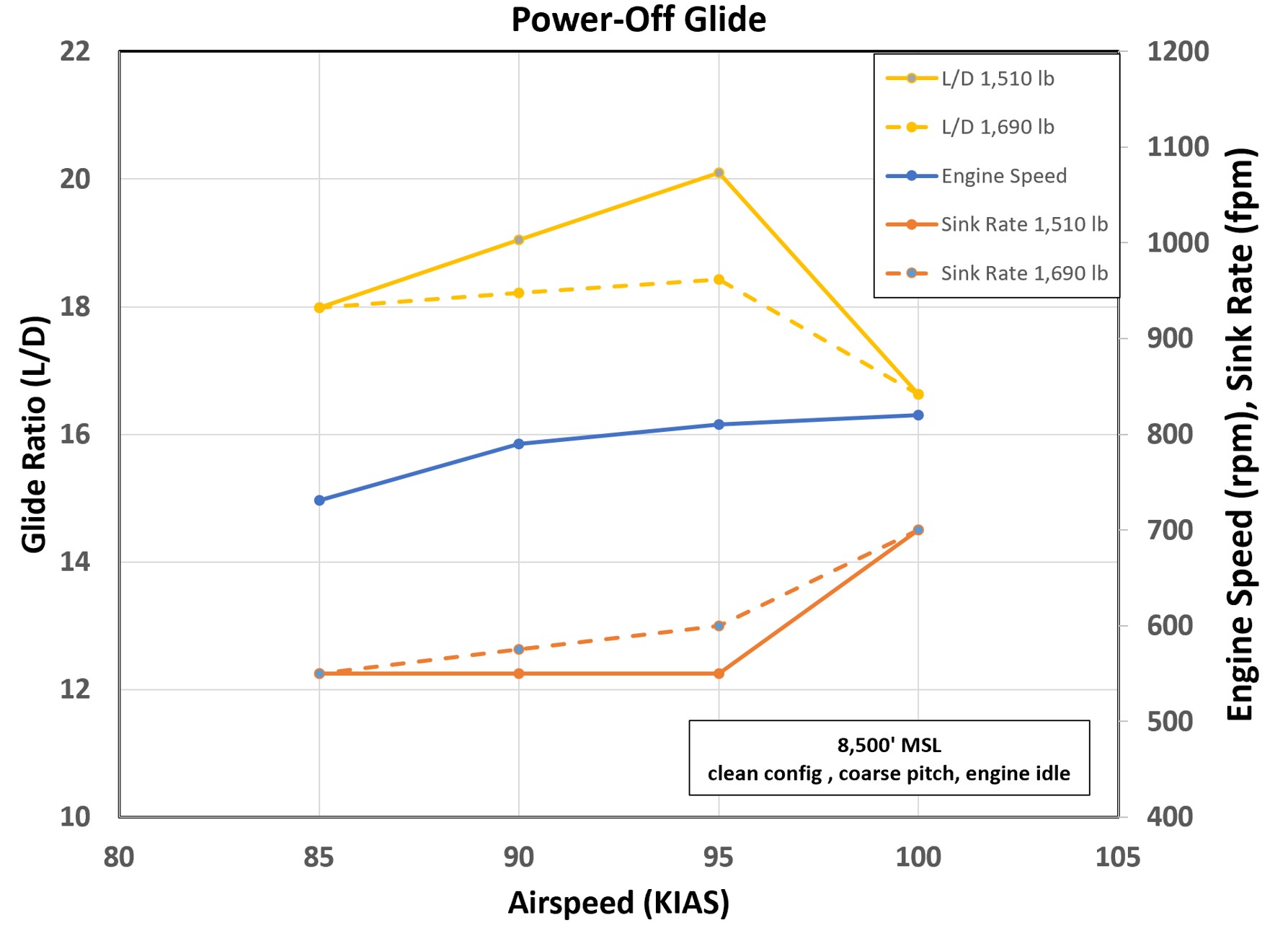

The results I posted are with full low RPM prop which is what I would use in a real power off glide. I tested one glide without touching the prop control (2300 RPM) to determine the effect of a "flat prop" against the airflow. This resulted in a glide ratio of about 7.8:1, compared with about 9.5:1 for full low RPM.Chris Zavatson wrote: ↑Sat Aug 24, 2024 7:28 pm What was the propeller rpm? The prop is a huge drag source, the lower the rpm, the lower the drag. In some cases the lowest rpm limited by design, in other cases it is an adjustment issue.
- Posts: 49
I suspect the propeller rpm is still quite high even-though the control is pulled all the way out. I would have expected a glide ratio between 15 and 20 on the IV.

Rock,
This topic came up several years ago. Bob Pastusek had posted his numbers. They looked much better. I suspect it is tied to differences in governed rpm. For a while Lancair was selling governors that had a very restricted rpm range.
posted by Bob back in June 2011
My IV-P has a glide ratio (at 120 KIAS) of between 5:1 and 20:1, depending on configuration. The difference is truly amazing/impressive/sobering… depending on your situation and mind set. With the gear and flaps down and the RPM at max (prop all the way in), the glide ratio approximates that of a brick…not really, but you’re coming down so fast relative to forward progress that it’s difficult to plan and execute a planned touchdown (at least for me). With the gear and flaps up, AND THE PROP CONTROL ALL THE WAY OUT, my glide ratio at gross weight is approximately 18:1, increasing to a bit better than 20:1 at 800# under gross. At this glide ratio, the performance and “sight picture” approximates that of some gliders........My MT 4-blade is not full feathering, but allows the engine to run at approximately 700 RPM when at idle and the RPM set to min..
